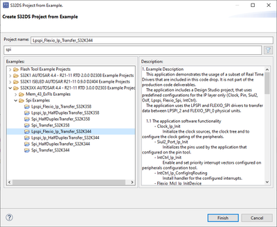

Julián_AragónM
Hi @semiconductor_user,
You can try one of the examples from the RTD package (Lpspi_Flexio_Ip_Transfer_S32K344 or Spi_Transfer_S32K344). You can modify the transfer buffer and test the API functions.
Julián
