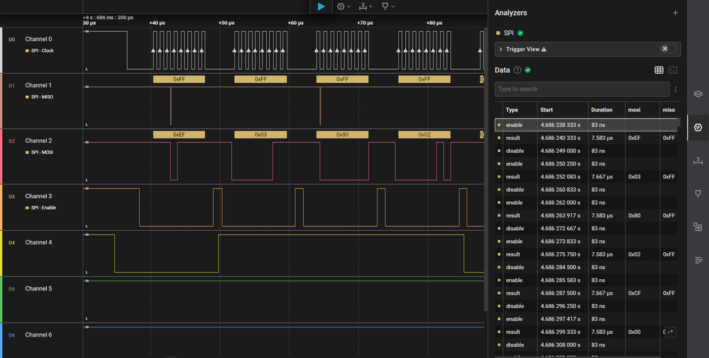

Arjun2
Hi @Julián_AragónM ,
Certainly, we can compare the data send in both S32 and STM32. I have attached the screenshots for your reference.
Can I add a component to an example project. I tried but I'm not able to do so.
This is for the S32K
This is the S32KThis is the S32K
This is for the STM32
9,860 Views
Julián_AragónM
Hi @Arjun2
This is clearly not the same frame or commands being sent. Have you ported over the display's library?
