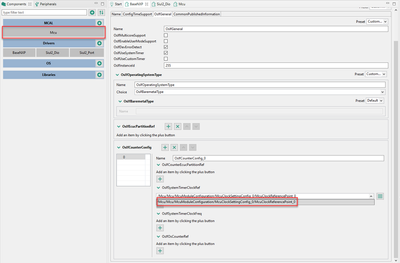

IDE : s32ds for platform v3.5
MCU : s32k324
here i want to use delay function by for 100ms for that i want to use OsIf but in configuration side i'm face issue, that screenshort i atteched below
please share example code for configuration osif and use delay function
or step for this procedure from configuration and which API will need.
please share in details so that i can easily understand and it will benificial for other more developers

Julián_AragónM
Hi @semiconductor_user,
In order to use the TimerClockRef, you need to add the Mcu module in the MCAL layer, which will generate the clock reference point:
If you have no need for the MCAL layer, you can also add the "TimerClockFreq" input:
The default frequency for the system timer is 48MHz. You can use the "OsIf_Init(NULL)" function to initialize the module, and the APIs included in "OsIf_Timer.c" to create a delay function:
  • OsIf_GetCounter
  • OsIf_MicrosToTicks
  • OsIf_GetElapsed
Julián

semiconductor_user
thank you @Julián_AragónM Julián_AragónM for reasponse
i done configuration for that i added Mcu module in MCAL Layer so got McuClockRefpoint.
now as you say using this API i can write delay function
  • OsIf_GetCounter
  • OsIf_GetElapsed
i'm trying to write function but not getting clearity. do you have example code or screenshort then please share here otherwise guide me

semiconductor_user
thank you so much for support. it is working perfact.
and i attached document below, which can help to community.
