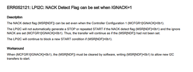

Thanks for reminding me, I actually saw IGNACK this errata.Senlent_0-1751262581075.pngSenlent_0-1751262581075.png
So, your guess is right,
https://www.nxp.com/products/S32K1

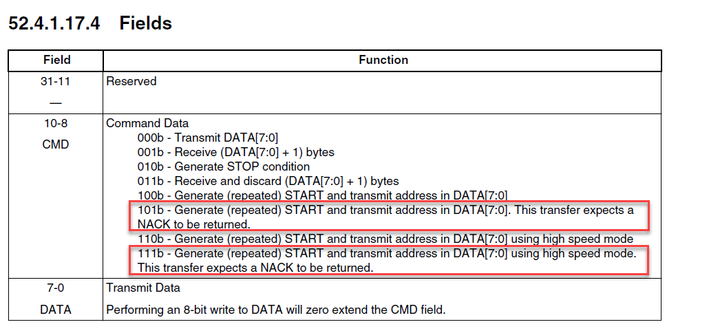

Regarding your question, I think the following situation may cause your situation.

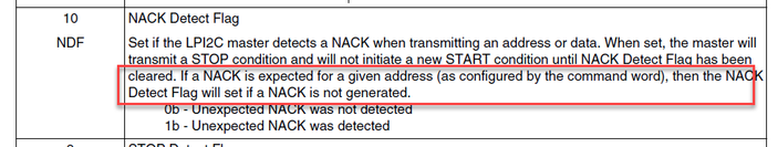

First, let's look at the description of the NDF register:
From this sentence, we can know that if we set it at the beginning to expect to receive NACK, but we did not receive NACK, then the NDF bit will also be set.
For example, if we set CMD to expect to receive NACK, but we actually received ACK, then NDF will be set. At this time, you need to manually clear the NDF bit to start a new transmission.
The above is my understanding, you can check the CMD settings, this may be the cause of the problem.

Joey_van_Hummel
Hi @Senlent,

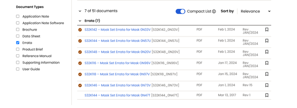

Thank you for confirming. I had found an old version of the erratum document which doesn't list this erratum.
I see that there are new versions which do list the problem.
Thank you for clearing this up and showing me the new erratum data. I've implemented the proposed workaround and that works.
