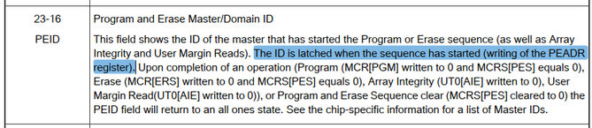

In Figure 2, the ID is just an example
This is done by the Master/Domain writting to the PEADR register.

I check the procedure and I think the sequence is correct but I still get the PES after writing DATA[0], I attach the code below, and I find in the UM and it mentiones that the PDATA could be writable after the PEADR is updated but it has some relationship with PEID. I do not care about the PEID when writing the DATA[0], do you think it will be the reason?
