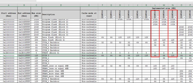

Hello, I'm using the S32K344 EVB board
Personally, I made the S32K314 PCB.
There was a problem that the power was not turned on, but the problem was solved.
However, the code based on the existing EVB board did not work on the board I made.
While looking up the data, LINKER_FLASH found that this part is different from 344 and 314.
int_itcm : ORIGIN = 0x00000000, LENGTH = 0x00010000 /* 64K */
While searching for data int_itcm: ORIGIN = 0x0000000000, LENGTH = 0x00008000 /* 64K */
int_dtcm : ORIGIN = 0x20000000, LENGTH = 0x00020000 /* 128K */
int_itcm : ORIGIN = 0x00000000, LENGTH = 0x00008000 /* 64K */
int_dtcm : ORIGIN = 0x20000000, LENGTH = 0x00010000 /* 128K */
Is there anything else I need to revise?
HARDFAULT error or
Break at address "0x2010000" with no debug information available, or outside of program code.
A warning message is displayed.

Hmm, there will be difference in access to TCMs.
As I am looking into memory map, the 314 has 64kB only. So that will be be the reason why you have
break at address "0x2010000"
