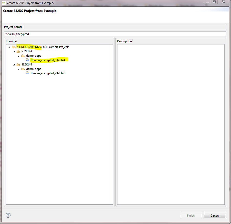

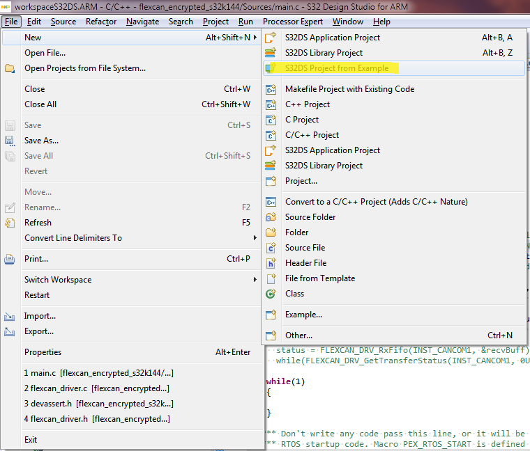

Please can you send me the Link or Path from where I can find the "flexcan_encrypted" example from the S32 SDK ?
I search the in S32K Design studio installation directory but I found so many FlexCAN examples and I am not sure which one I have to use.
6,036件の閲覧回数
AnaAldescu
Please use the S32DS Project From Example feature and use the search bar for finding the project.
