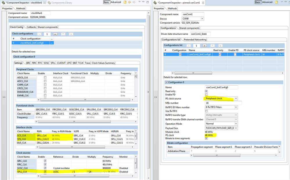

I am working on CAN driver for S32K.
I configured the FlexCAN0 with CAN FD disabled.( I just want  use CAN 2.0 ...., CAN FD is not required in our application).
I have query is that how I can use and configure the message buffers for CAN 2.0 format ?

dharmendrag
Hello Ana,
thank you i got the example projects for standard CAN (No CAN FD).
the example code is working fine with CLKSRC = 0 (The CAN engine clock source is the oscillator clock = 8Mhz.) I tested on Evaluation Board. I am bale to see the Frame(0x55) on CANalyzer tool.
But I want to use the CLKSRC = 1 (The CAN engine clock source is the peripheral clock.) in our application.
We have below Slow RUN configure clock setting in our application(S32K144).
SCG_RCCR[SCS] = 0011b .........CORE_CLK 48 MHz
SCG_RCCR[DIVCORE] = 0000b .....SYS_CLK 48 MHz
SCG_RCCR[DIVBUS] = 0000b ......BUS_CLK 48 MHz (max freq. in RUN mode)
SCG_RCCR[DIVSLOW] = 0001b .....FLASH_CLK 24 MHz
I did the Bit Timing calculation with below parameters.(I have refer the simple guide FlexCAN bit timing calculation ).
Bit rate = 500k bit per second
Bus length = 10m
Bus propagation delay = 5 x 10-9 s/m
Physical Interface (TJA1040) transmitter plus receiver propagation delay = 150ns at 85C
CPI_clock = 48 MHz
Calculated Bit Timing parameters values are :
NBT = 16
Prescaler = 6
PROP_SEG = 3
PHASE_SEG1 = 6
PHASE_SEG2 = 6
RJW = 4
CTRL1 register update with below value.
CAN0->CTRL1 = CAN_CTRL1_PRESDIV(6) | CAN_CTRL1_RJW(3) | CAN_CTRL1_PSEG1(6) | CAN_CTRL1_PSEG2(6) | CAN_CTRL1_PROPSEG(3) | CAN_CTRL1_CLKSRC(1) | CAN_CTRL1_SMP(1);
With this all setting I getting the CAN signals on Oscilloscope but on CANalyzer i am getting error frames.
Is there any thing wrong in bit timing calculation or clock setting ?
or I have to change any other settings for  CLKSRC = 1 ?
The same example code is working fine with CLKSRC = 0 (The CAN engine clock source is the oscillator clock = 8Mz.)
5,859 Views
AnaAldescu
For a bitrate = 500 Kbit/s and a PE clock = 48 MHz, I computed the following time segments:
Prescaler = 5
PROP_SEG = 7
PHASE_SEG1 = 4
PHASE_SEG2 = 1
RJW = 1
But there can be variations of these values that can achieve the same bitrate. Other than that, if the peripheral clock used to source the CAN PE clock is FIRC, the bitrate will not be exactly 500 kbit/s due to the 2% deviation of FIRC.
When the CAN PE clock uses the peripheral clock, this is sourced from the system clock. In order to avoid the above problem, you can set SCS_CLK to use SPLL_CLK (which has a smaller deviation than FIRC).
If you are using Design Studio, please follow the instructions in the attached image.
Ana
