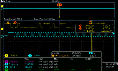

I tested LPSPI slave mode using AUTOSAR API. When I setting LPSPI2 Slave mode and DMA + Half-duflex configuration, First response was correct. However, Second response is wrong.
I think the LPSPI data bit is being read from the first rising edge.
In the second response, 1 bit is shifted backward, and in the third response, 2 bits are shifted backward.
Please refer to the data table comparing my expected data and Rx data.

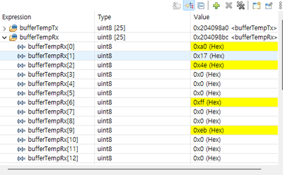

 Expected data     RX data (read buffer data)
1st RX dataA0034E   A0034E
2nd RX dataA0034E   D00BA7
3rd RX dataA0034E   E805D3
Is there anything that needs to be modified to solve the problem?

Hi @WW1984,
With this configuration, the Slave device should capture the RX data on the falling edge of SCK.
And in the waveform, there is the first falling edge during the 8th bit of 0xA0 (MSB first).
Can you share the waveforms along the CS signal?
BR, Daniel

WW1984
Hi @danielmartynek ,
I updated CS Pin waveform.
 1st Response data
 2nd Response Data
3rd Response Data
Best regards.

danielmartynek
Thi is a screenshot of the first frame right?
How the frames (including CS) that are incorrectly received look at the oscilloscope?
4,528 Views
WW1984
There was no difference on incorrectly received frame.
According to my analysis, old data in shifter seemed to be append to first bit of current RX FIFO.
So I made work around to do following codes to clear old data in shifter every time RX finished.
        Base->CR |= LPSPI_CR_RST_MASK;
        Base->CR &= ~LPSPI_CR_RST_MASK;
By above codes, responses from device could be received correctly.
Could you check why old data in shifter couldn't be cleared after RX process was done?

Also, the screenshot you posted does not seem to match the data you want to receive.

As you mentioned, the waveform signals are 0xA0 (MSB first).
However, In the RX buffer data are incorrect at second read data.
 Since the CS pin is not used in the MASTER IC, the CS pin is asserted from the start of the main function to the end.
I will modify the logic to assert CS pin before receiving RX and share the waveform after testing.
