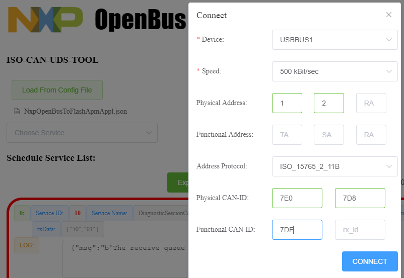

I try to setup 11bit CAN ID in the NXP OpenBus tool,
I find if the ID under 0x7DE is work, but if the ID more than 0x7DF, NxpOpenBus will send nothing,
I want to setup CAN ID as below picture.
Snaku

   This an issue. In the next version, we will solve the issue.
Thanks!

I already modify the unified bootloader CAN ID in user_config.h, my question is not in MCU side, my problem is the NxpOpenBus.exe doesn't send CAN frames with CAN ID 0x7E0 when I use ISO_156765_2_11B mode.
Regards, Snaku
