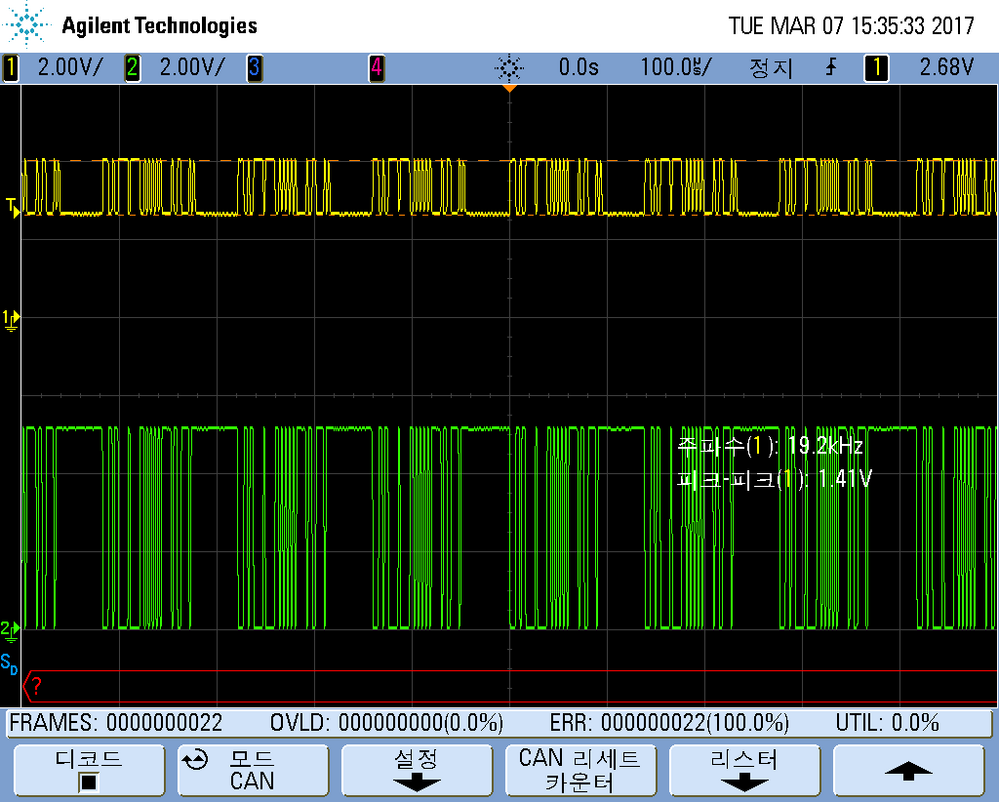

Hi.
I try to send a CAN message and it works.
But there is a problem.
I send a CAN message only 1 time but several CAN messages are sent. (refer to below picture)
I have to send a CAN message only 1 time.
What should I do?
■ MCU : S32K144(68pin)
■ Picture
  - 1 : CAN high at CAN transceiver
  - 2 : CAN TX at MCU
■ Code

1,336 Views
martin_kovar
I am not S32K SDK expert, but it looks like you did not receive acknowledge from receiving frame, so your microcontroller repeat the transmission again and again.
What is the connected on your CAN bus? Is there any other device or microcontroller?
Martin
1,336 Views
kimjunghyun
Hi.
I connected PCB to VN1630.
Now I solved this problem. I changed CANsend code from for(;;) to LPIT ISR() and above situation was dissappeared.
I thought when I push the button CANsend code was activated several times.
Thank you.
