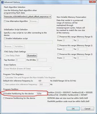

Dears,
Usually  I program S32K146 by P&E according to the setting as followed. And the MCU works well.
Yesterday I tried to program by JLink, but I couldn't find similar entry to enable partitioning. Discarding this setting, I programmed the MCU, but it didn't  work properly. Can anybody help me to  to program S32K146 to enable partitioning by JLink under S32K Studio 2.2 ?
2,019 Views
danielmartynek
Hello @jack_zmh,
I'm afraid there is no such option in S32DS.
There is an option to use J-link commander though:
https://wiki.segger.com/S32Kxxx
I would recommend contacting Segger support for more information,
BR, Daniel
2,001 Views
jack_zmh
Thanks Danel. It's helpful, even though this is not a perfect answer.
