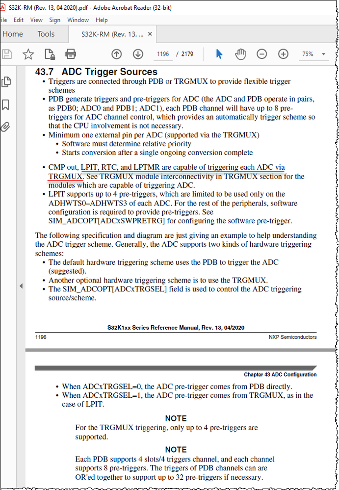

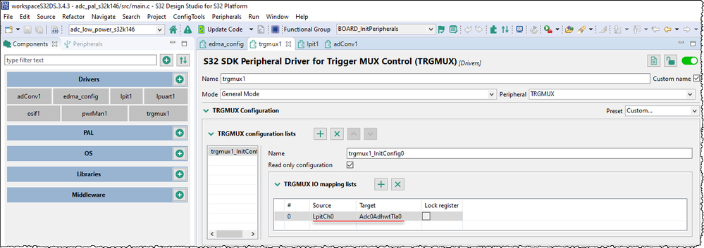

If you don't need to ADC sample synchronously with PWM(FTM), just want to ADC sample one channel periodically. Please refer to the adc_low_power_s32k146 demo project of S32K1 SDK. LPIT was selected to periodically trigger ADC sample in that project.
