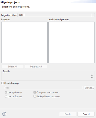

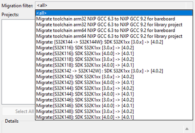

I have downloaded the universal bootloader projects and I can see that the S32K1xx examples were developed using S32DS for Arm. Based on this discussion (https://community.nxp.com/t5/S32K/OTA-using-UDS-over-the-CAN/td-p/1640549) it looks like it uses S32DS for Arm 2018.R1 and S32K1xx SDK RTM 2.0.0. However, I am currently using the S32DS for S32 Platform 3.4 IDE, would like to avoid using S32DS for Arm. I tried following the steps here (https://community.nxp.com/t5/S32-Design-Studio-Knowledge-Base/Video-Migrating-S32K1-projects-from-S3...) to migrate the project to be an S32DS for S32 Platform 3.4 project. However, the S32K144 project (S32K144_CANFD_bootloader) does not appear in the list (see screenshot below). I believe this may be because you can only migrate from RTM 3.0.x, while this project uses 2.0.0. (I have attached a second screenshot below to show the migration filter options that appear for me.)
Is there a version of the S32K144_CANFD_bootloader project that was developed using S32DS for S32 Platform? Or, is there a method that I can use to migrate it that I am missing? Perhaps if I install S32DS for Arm, I can update the SDK version to 3.0.x and then migrate it using the migration menu in S32DS for S32 Platform?

there's a problem with compatibility between older versions of SDK, so there's no simple way how to migrate a project from 2.0.0 to 3.0.0. The only option is to migrate the project manually - in this case it can be migrated directly to the latest version.

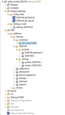

And here is the structure for an example project (hello_world) created using S32DS 3.4):
I can see that the key linker/source/startup files are mostly the same. (At least, in name; I assume that the contents are the same too.) The only difference is that the S32DS 3.4 hello_world project is missing the flexnvm linker file.

I recommend to create new application project without SDK. The hello_world example uses SDK and it inserts unnecessary things:

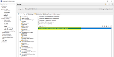

The bootloader is executed from FlexNVM. If you want to do the same, copy also the linker file and then you need to change the project settings to use this file. Change it here:
Then copy the source files from src folder. The best way is to use drag&drop directly to S32DS to Project Explorer window.
