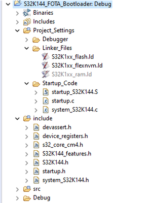

Here is the project structure for the AN12323 bootloader project, created using S32DS for arm 2018.r1 as you mentioned:
And here is the structure for an example project (hello_world) created using S32DS 3.4):
I can see that the key linker/source/startup files are mostly the same. (At least, in name; I assume that the contents are the same too.) The only difference is that the S32DS 3.4 hello_world project is missing the flexnvm linker file.
So, to migrate the project, would I just need to create a new project in S32DS 3.4 (e.g., could base it off of the hello_world example), replace the src directory with the src directory from the AN12323 bootloader project, and copy the flexnvm linker file over as well? If so, are there any changes that I would need to make to the linker file to account for the IDE difference? And are there any other things that I need to do to complete the migration that I am missing?
Thank you for your help!

I recommend to create new application project without SDK. The hello_world example uses SDK and it inserts unnecessary things:
The bootloader is executed from FlexNVM. If you want to do the same, copy also the linker file and then you need to change the project settings to use this file. Change it here:
Then copy the source files from src folder. The best way is to use drag&drop directly to S32DS to Project Explorer window.
Now I'm not sure about the headers in include folder. You can try if it is possible to compile the project or if something is missing...
