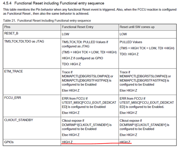

I want keep some pin( which control power supply of MCU ) state during functional reset ,  dose S32K3xx support keep PIN in High level during functional reset ???

Hi@liwenchao
The state of the GPIO cannot be controlled during functional reset, and its default state is high impedance.
