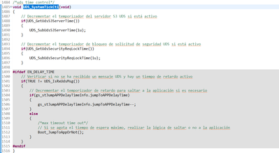

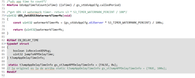

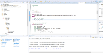

JonAnder_Amante

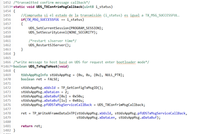

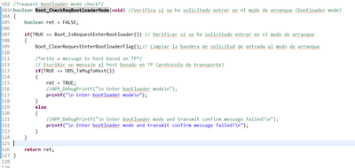

Hi, I am using the project "S32K344_Can_bootloader_RTD200" in the microprocessor S32K344. I want to download an application with the program of bootloader. I have achieved the jump from program to application but I have different questions. 1. I want to use #define EN_DELAY_TIME but when I uncomment the command in the folder "public_in", the program has different errors. My target to use "Backdoor", that is to say, I want to check if the program has to enter to bootloader or not. I don´t know the process and the different functions that I have to use to achieve the target. I want to use the function "Boot_CheckReqBootloaderMode(void)" but when I debug the program, it never enters to the "if". Could you explain me the process and the steps to achieve the target. I add different functions that I think are important. 2. I don´t know if I have to modificate the parameters of "static tJumpAppDelayTimeInfo gs_stJumpAPPDelayTimeInfo = {FALSE, 0u};". I have to change this structure ? You can see all structure in one of the next pictures. I need the reply as soon as possible since I have to send a project very soon.
Thank you for all,

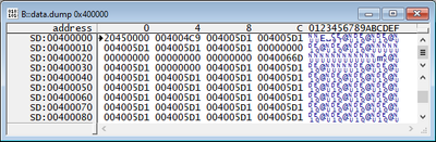

Hi Zhend,
this code will work if the provided address is an address of reset vector. In your case, it looks like you provide an address which is directly address of entry point.
Example:
This is my vector table:
Reset vector can be found at 0x00400004. So, entry point address is 0x004004C8.
Using you code, it should be called like this:
resetHandle = (AppAddr)(*(uint32_t *)0x00400004);
(resetHandle)();
Lukas
