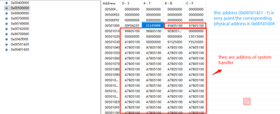

The corresponding memory conten is shown as below:
In my case, the 0x00501004 is physical address of reset vector, is that right?
But I tried to jump 0x00501004 and got failure again!
Did I miss any key point?

KalaimaniArumugamdev
Hi @zp001
           First of all, EPSR means Execution Program Status Register, EPSR. Before getting to this might help you  https://developer.arm.com/documentation/ddi0419/c/System-Level-Architecture/System-Level-Programmers...
     This kind of multi-project in a single MCU design requires a deinitialization process on every jump. Also vector table reallocation and PS & SP. Also, try to jump to 0x00501000 instated 0x00501004.
8,886 Views
zp001
@KalaimaniArumugamdev ,
Thank you for your reply!
Finally, the code can be run normally by using 0x00501004 as entry of APP image.
Thank you all.
