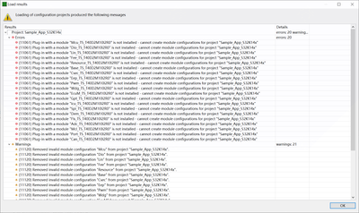

I'm trying to import "S32K14X_CSEC_MCAL4_0_RTM_1_0_4_Sample_Application" to EB Tresos(21.0.0), but suffer some issues:
1 "load configuration" reports below error logs: (11061) Plug-in with a module "Mcu_TS_T40D2M1012R0" is not installed - cannot create module configurations for project"Sample_App_S32K14x" ..
2 launch.bat failed with below error:
(11061) Plug-in with a module "Mcu_TS_T40D2M1012R0" is not installed - cannot create module configurations for project"Sample_App_S32K14x" I tried several different version of gcc ,all failed: gcc-arm-none-eabi-6-2017-q2-update-win32 gcc-arm-none-eabi-4_9-2015q3-20150921-win32 C:\NXP\S32DS_ARM_v1.3\Cross_Tools\gcc-arm-none-eabi-4_9

Hi qpzhang,
1. About the issue of plugins
Basically due to the sample app is using the different version of MCAL than your current using MCAL, so the EB Tresos can't find the folder.
I see the name of module Mcu_TS_T40D2M1012R0, i guess it will different name with your Mcu plugins in the current package, that's why the project can't be built.
Solution is you should use the Sample APP matching with correct MCAL package
Or you create a new project with your current package
