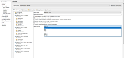

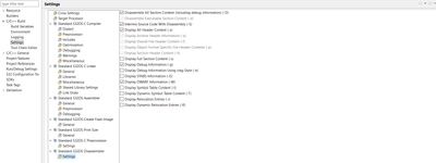

I want to generate a DWARF file. I was looking in the project settings and found the following settings. I checked the "Displat DWARF&Debug information" settings. I selected the debug format as DWARF. I cleaned the project and build it. I did not find any ".dwarf files" in the output files. Cand the information be found in the ELF file? Is it generated as an ELF file instead of a DWARF file?

It does not generate any additional file.
DWARF only chooses debugging information format used in the ELF file.
