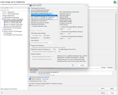

Our project has encountered an issue regarding D-flash erasure. When flashing the .elf or .S19 file using PE , we found that the D-flash is not erased after the flashing process—it still retains residual values. We want the D-flash to be erased every time we flash via PE. Additionally, the project uses the S32K314 chip. May I ask what could be the reason for this? Thank you!

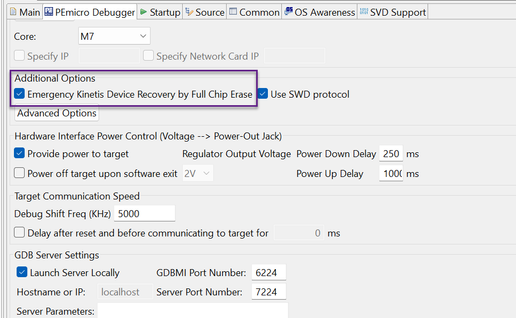

The PE Micro debugger is not an NXP product.
The S32DS IDE integrates GDB Server Plug-In for Eclipse-based ARM IDEs, and this is a PE Micro product.
https://www.pemicro.com/products/product_viewDetails.cfm?product_id=15320151
The plugin has this option:
Please contact PE Micro support to get details about their proprietary algorithm,
Thank you,
