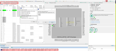

Regarding pins configuration you can check all the possible configurations for each pin in the Pins configuration tools section in your S32DS IDE, as you can see in the following image:
Additionally, you can refer to the attached S32K1xx_IO_Signal_Description_Input_Multiplexing.xlsx files in the Reference Manual for the Pinout for your specific controller.
