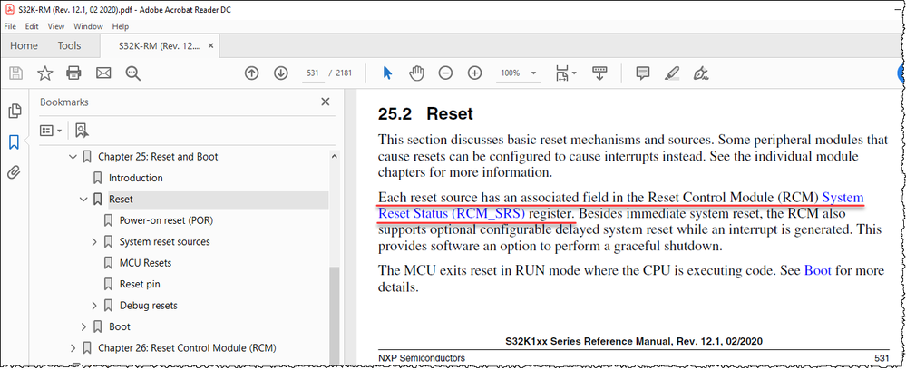

Robin_Shen
Hi Ken3,
Each reset source has an associated field in the Reset Control Module (RCM) System Reset Status (RCM_SRS) register.
You can check the vaule of RCM_SRS.
Robin

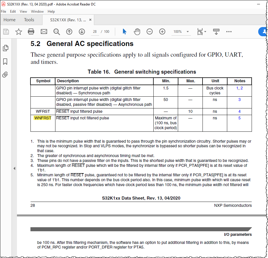

Is there a min-max specification for the length of the Low signal applied to the reset pin during power on?
2,133 Views
Robin_Shen
I only find this: WNFRST is the recommended external reset low pulse Min.
