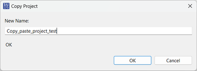

How to create copy of existing RTD project in the same workspace with different name in S32DS for S32

In Project Explorer of S32DS, you can directly copy-paste the required project and it will open a window to select new name:
You can also rename the .mex file.
