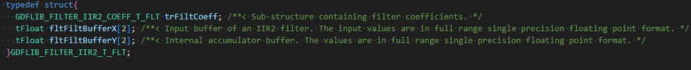

I am trying to use the AMMCLib in my project, but I am missing some information about how to implement the GDFLIB second-order filter.
but I am not getting the values I expect. I am unsure about the purpose of these buffers
fltFiltBufferX
and
fltFiltBufferY
Could you provide some guidance on how to properly use them?

3.15 GDFLIB_FilterIIR2 section of S32K3XXMCLUG gives more details and code example about it.
You can find such filet in C:\NXP\AMMCLIB\S32K3xx_AMMCLIB_v1.1.39\doc.
Hope it helps you. Please let me know if you have more questions about it.

i had a look at that document.
I have implemented an IIR filter in my project, which needs to be called periodically. However, the filter only works if I initialize it before each call, which resets the filter. This periodic reset is not acceptable for my design. If I initialize the filter only once at the beginning, it returns NaN values, indicating that the filter is not functioning correctly. Could you please provide an example of how to use the IIR filter effectively for periodic data filtering?
for
GDFLIB_FilterIIR2Init_FLT
and
GDFLIB_FilterIIR2_FLT
