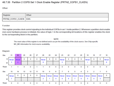

am currently using the TCM feature of S32K3x in my RTD.
I encountered an issue while configuring the TCM clock:
According to the source code of RTD, it is necessary to configure a macro definition, CLOCK_IP_HAS_TCM_CM7_0_CLK,  before configuring the TCM clock.
However, there is currently no corresponding place for CLOCK_IP_HAS_TCM_CM7_0_CLK.
I also couldn't find any configuration options for the TCM clock in S32DS software.
Should I manually modify Clock_Ip_Cfg_Defines.h to add this configuration?
(I'm using S32K312 Project)

Hi @Chris-Sun
The PRTN2_COFB1_CLKEN[REQ62] field for Cortex-M7_0 is enabled at reset as you can see from the image below:
B.R.
VaneB

Hi @VaneB
Thank you for your response to my post.
Your response resolved my confusion.
Chris
