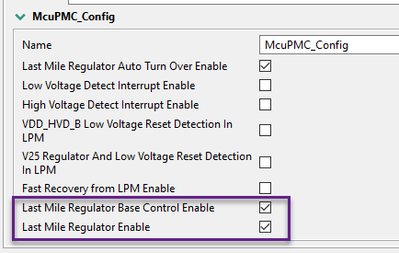

Hi Team
We would like to configure the 7th pin(PTE13) of S32K342(MQFP100) to VRC_CTRL. The attached screenshot(attached 1) shows that it can be configured to PMC VRC. However, when I choose this pin and plan to configure it, there is no PMC VRC(see attached screenshot 2).
I attached the specific configuration and the code I add into project below. When I debug the project, the register CONFIG remains unchanged(see attached screenshot). Then what should I do to make it?
Best Regards
Hermit

Hello @Hermit,
You have probably an old RTD version.
In the latest version, there is PG, vrc_ctrl
But this is selected by default out of reset, so there is no need to initialize the pin in the SW.
The Power_Ip_Init() initialize the Config register.
If it does not, can you update the latest RTD?
Do you use an NXP EVB or your own board?
BR, Daniel
