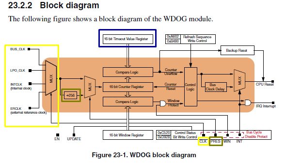

The timeout depends on the
  • WDOG clock source (WDOG_CS_CLK),
  • on the prescaler if enabled (WDOG_CS_PRES),
  • and on the value in Timeout Value Register (WDOG_TOVAL).

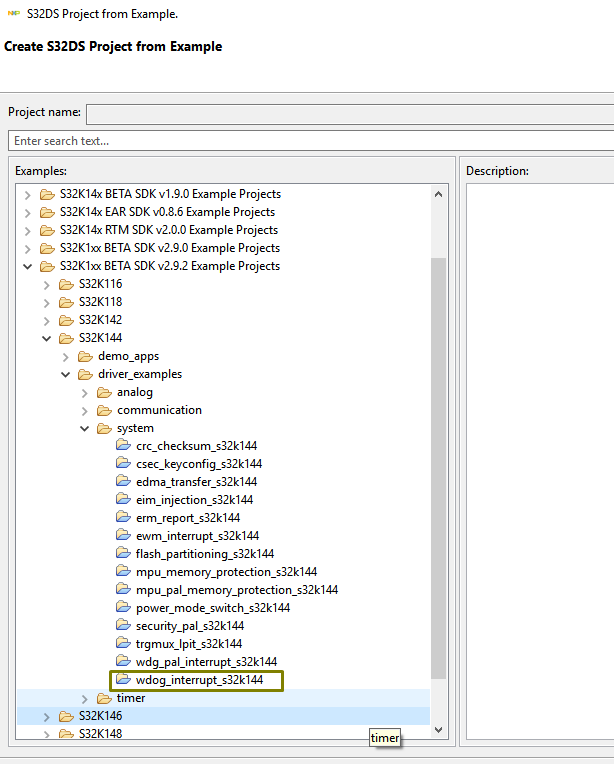

You can use the SDK WDOG driver:
Please refer to wdog_interrupt_s32k144 SDK example in S32 Design Studio:

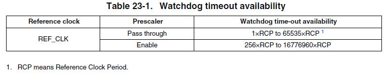

yes, i know about your reply
i know  watch timeout about  clock,prescaler and timeout value
can you provide calculation formula about wdg timeout?
such as
timeout = (1/(clk/(prescaler+1)) ) * timeout_value      (ms)  ?
is ths right?
thank you for your reply!   ☺
5,609 Views
danielmartynek
timeout (s) = (1 / clk) * TOVAL
or
timeout (s) = 256 * (1 / clk) * TOVAL
