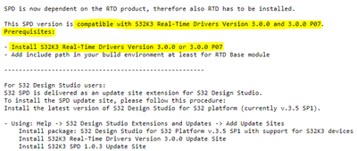

    My project has to be upgraded to fullfill ASILB, so the SPD has to be added to the original project which base on RTD 2.0.2. The MCU on my board is s32k312, but the SPD I downloaded from nxp only has a sample project base on s32k344, and it was built with many errors. The SPD should be free for users, is there a document discribing the way to add SPD to the program?

Hello @jhuang1,
This is a note in the Release Note of S32K3 Safety Peripheral Drivers version 1.0.3.

DanNguyenDuy
Hello @jhuang1,
