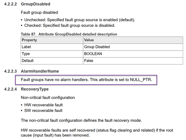

How do I edit the Alarm Handler Name in the Fault Groups section of the EMCEM module? It seems uneditable. I can edit the Alarm Handler Name in DCM Faults, but not in the Fault Groups section. Why is that?

Hi @Allen_863,
Refer to S32K3_SAF_EMCEM_UM.pdf that can be found in the installation directory.
The groups have no alarm handlers.
