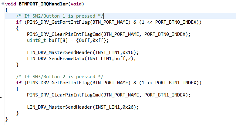

victor_song_171
I use LIN_DRV_MasterSendHeader function, it works, it can recieve frame header at LIN-MONITOR, but the LIN_DRV_SendFrameData function not so . Code below:
Need assistance and thanks a lot.
