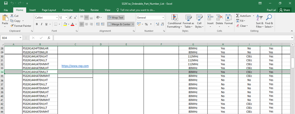

I am using chip FS32K144HAMLL which is expected to have CSE, but i am facing of issue of Hardfault on access to PRAM.(attached pic, it stuck on PRAM)
Debugger used: segger j-link base.
Example program tried: 1_configure_part_load_keys project from AN5401SW.
I have check this same project on S32K144EVB (with on board PE debugger) which has chip label PS32K144UAVLLA, it works.
Waiting for your comment!!
The chip what i used on my board seen to have CSE

Hi paullalthuamsanga,
   Please check the PRAM base address in S32K144.h. It should be #define CSE_PRAM_BASE (0x14000800u).
