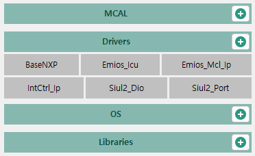

And then, as shown in the figure below, a component was added.

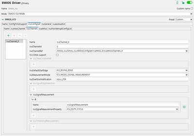

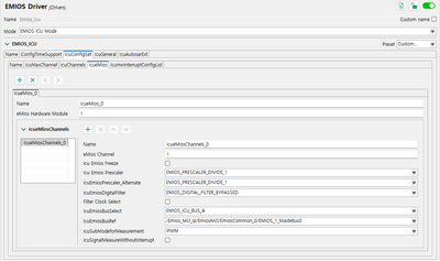

In the ICU component, IcuChannels, IcueMios, and IcuHwInterruptConfigList are set to the values ​​shown in the figure below.

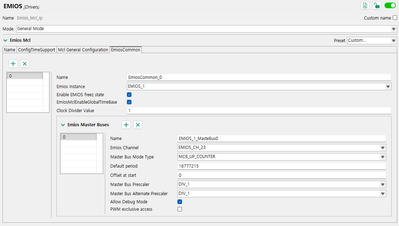

The EmiosCommon setting value in the Mcl component is set as shown in the figure below.

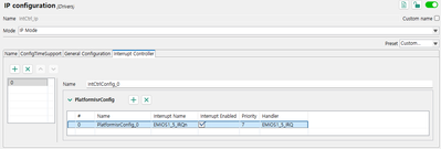

The Interrupt Controller setting value for the IntCtrl component is set as shown in the figure below.

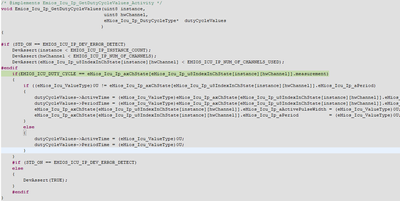

The EMIOS_ICU_DUTY_CYCLE check part in the Emios_Icu_Ip_GetDutyCycleValues ​​function is always EMIOS_ICU_NO_MEASUREMENT(eMios_Icu_Ip_axChState[eMios_Icu_Ip_u8IndexInChState[instance][hwChannel]].measurement).
