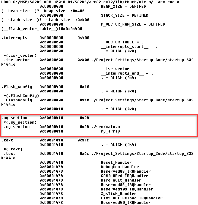

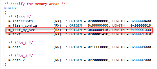

This document describes a way, how to place custom constant data into specific flash memory area.
  • Create a custom linker section in the linker file (.ld), where custom data should be placed into. pastedImage_3.png
  • Use the KEEP keyword in case you would like to avoid dead stripping if and object is not referenced.
  • add the __attribute__ section statements to the custom data definition.pastedImage_5.png
  • Map file should looks like this way
Hope it helps.
