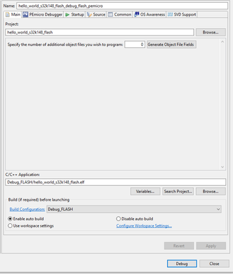

I tried to flash the example code hello_world_s32K148 to the S32K148EVB. disconnect and connect the 12V power back, while the code is gone.
below is my procedure to flash the board:

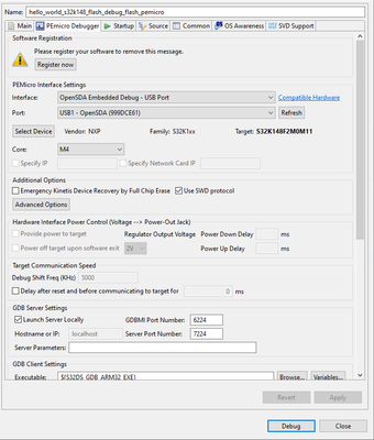

next I went to debug configuration
After click debug, the code is execute (LED start blinking), but after I power-up again or press reset the flashed program will be gone.
Can you please help to suggest what's the correct way to flash the board?

Hi@Juan_Juan
I see no problem with your debug configuration and no problem on myside.
