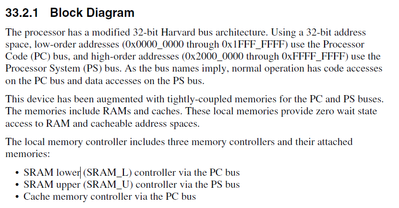

At first, I would like to suggest looking at RM rev 12.1 section 33.2.1. Each region uses a different bus:
When you look at the linker file of some project, you can see that SRAM_L (m_data) includes the code_ram section, global variables, vector table. SRAM_U (m_data_2) contains stack and heap.

what is main difference between CODE BUS & SYSTEM BUS? (both of them come from CPU?)
and what can be "critical code" ?
