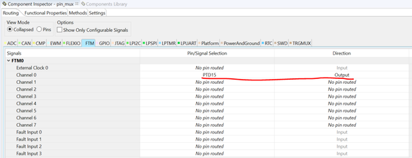

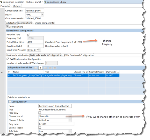

          FTM(PWM)  may meet you needs.
          There is a route in S32 DS,ftm_pwm_s32k144,this example application showing the FTM's PWM functionality.
Usage or detail please refer to "ftm_pwm.dox" .
How to change the project to generate 1000hz square signal.
STEP1:
PTD15 is associated with FTM0 channel 0

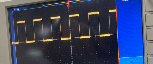

Ok this method is good but in your example I generate 1000Hz digital signal (square signal) and I use FTM. How can I generate the same signal using only GPIO?
