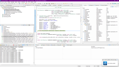

Hi, @lukaszadrapa
I'm using
HseResponse = HashDataDefSrv(HSE_HASH_ALGO_SHA2_256,(uint32_t) sizeof(test), test, &image_hash_length, image_hash, HSE_SGT_OPTION_NONE);
function for calculating the HASH of an image stored as const uint_8 [], and I'm getting returned with Parameter Invalid. So I decided to test the hash on a smaller array, but with a similar issue.
Please help in resolving this issue!
Additionally, I found a glitch when using HSE with RTD 3.0.0, which is:-
When I run my code without any breakpoint, my HSE API are always responding NOT_OK(not ok means anything besides the HSE_OK or HSE_SUCCESS), but when I manually jump over these API, I get HSE_SUCCESS

lukaszadrapa
If it is not caused by data cache, I would need more details for both issues.
For the hash service, could you take a screenshot of the service descriptor right before sending it to HSE?
And regarding the second issue - could you check what error code was returned by HSE exactly? If it works when stepping the code, it could be some kind of timing issue or coherency issue. Did you try to disable interrupts when executing these HSE services?

R_S002
Hi @lukaszadrapa
Image of HASH Function before execution

lukaszadrapa
I did very quick test on my board and I can see the same problem. I have never had a problem with hashing, so let me check what's going on. I'm running out of time today, so I will check it next week.

lukaszadrapa
Ok, it's caused by pHashLength, most likely. The variable where this pointer points must be initialized to size of your hash buffer. It must not be zero. HSE Service API reference manual says:
"INPUT/OUTPUT: Pointer to a uint32_t location in which the hash length
in bytes is stored. On calling this service, this parameter shall contain the
size of the buffer provided by host. When the request has fi nished, the
actual length of the returned value shall be stored. If the buffer is smaller
than the size of the hash, the hash will be truncated"
So, please check the content of this parameter.
