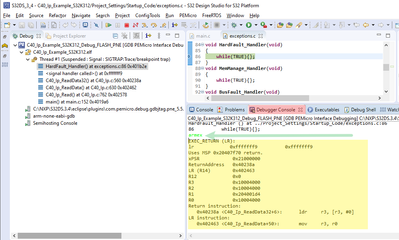

If you met hardfault when debugging with S32DS 3.4, you can do the follow steps and find the information where triggered the hardfault.

  2. Place the file into the folder of S32DS_3.x, like C:\NXP\S32DS_3.4\S32DS\build_tools
  3. In S32DS, S32DS –> Window –> Performances –> Debug –> GDB –> GDB command file
    Set as below
  4. Debug as general and when meet hardfault, you can input armex in Debugger Console to get more information from stack
Cheers!
