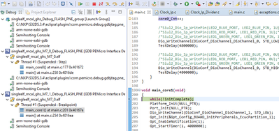

hi,
   when i using greenhills compiler plugin compile the s32k324 mcal program port from s32ds v3.4's example application(Platform_Multicore_SingleElf_S32K324). it compile succeful,but can't run.
when i debug use pe, core0 main enter a hardfault.
who can help me? thanks.

xflong
I am using S32K3X4EVB-Q257 ,the chip on the board is S32K344,but it was decoupled,so it is really a S32K324. It has no HSE firmware,I tested the demo "Platform_Multicore_SingleElf_S32K324" from S32DS  v3.4 ,it can work.
Maybe I uploaded the wrong project.But the two cores don't work correct.The correct is two red leds blink.

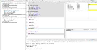

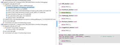

xflongzhang_0-1660132626679.pngxflongzhang_0-1660132626679.pngxflongzhang_1-1660132675242.pngxflongzhang_1-1660132675242.png
5,735 Views
DanNguyenDuy
Hello xflongzhang,
I got your error. I saw that this interrupt is PIT_0_ISR after I check the below registers.
I didn't why the PIT_0_ISR function didn't install after calling the Platform_Init(NULL_PTR); in the main_core0() function.

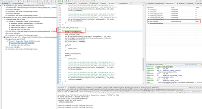

I have a solution: you can add the statement calling Platform_InstallIrqHandler function as the below image. After that, rebuild and test again.
Dan
5,732 Views
xflong
Hello,Dan,
Thank you very much for your advice. But I still encountered the same problem. Is there anything else wrong?
