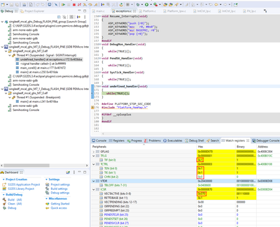

hi,
   when i using greenhills compiler plugin compile the s32k324 mcal program port from s32ds v3.4's example application(Platform_Multicore_SingleElf_S32K324). it compile succeful,but can't run.
when i debug use pe, core0 main enter a hardfault.
who can help me? thanks.

DanNguyenDuy
Hello xflongzhang,
I got your error. I saw that this interrupt is PIT_0_ISR after I check the below registers.
I didn't why the PIT_0_ISR function didn't install after calling the Platform_Init(NULL_PTR); in the main_core0() function.
I have a solution: you can add the statement calling Platform_InstallIrqHandler function as the below image. After that, rebuild and test again.
Dan
5,880件の閲覧回数
xflong
Hello,Dan,
Thank you very much for your advice. But I still encountered the same problem. Is there anything else wrong?

xflong
Hi Dan,
I added MPU_ENABLE to the compiler options, rebuild the program and find that the program can run correctly. It is surprising that the code generated by the same RTD version is different from the example. But the problem was solved.
