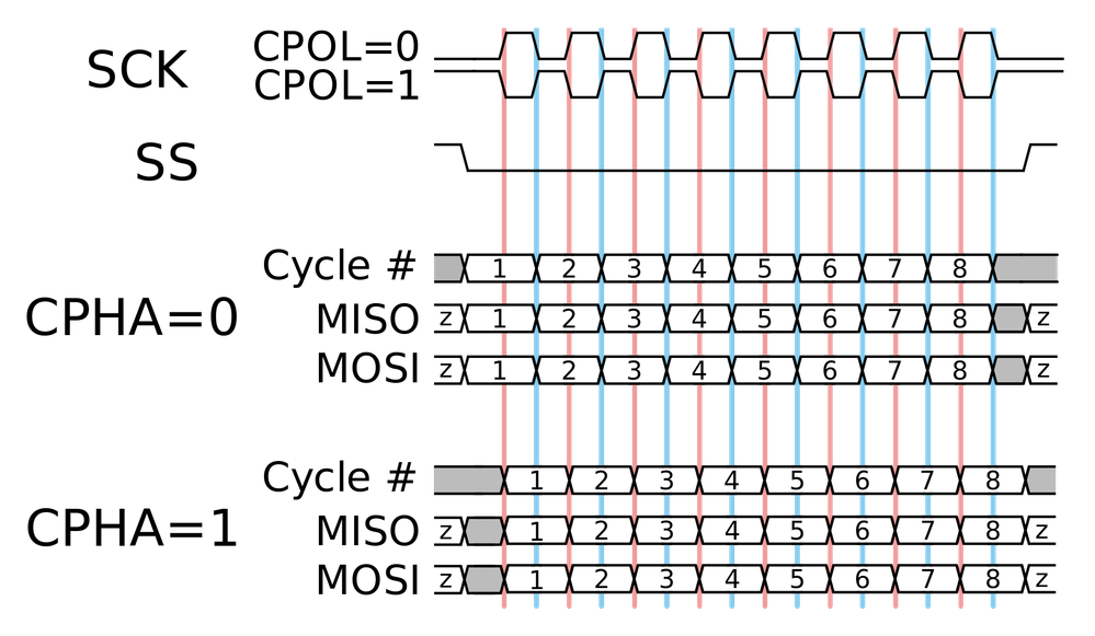

Robin_Shen
Hi Dilip1441,
How did you configure the CPHA and CPOL of slave device? Here you can refer to the signal captured by external logic analyze.

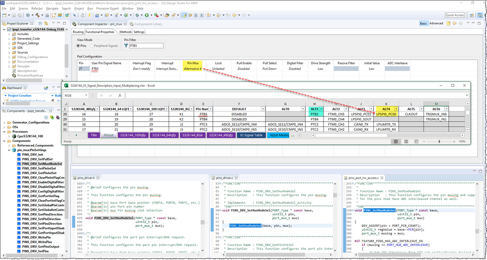

Hi, Now i'm using lspi_transfer_s32k144(SDK) Example Code, Using that code i'm trying to communicate LTC6813(ADC Board), Before Data Writing to the ADC Over the SPI, I need to Wakeup the ADC by CS Pin after that need to Write the Data.
But Unable to control the CS Pin Separately, Please check the below code, and PFA For the Required Wakeup Signal From Master-S32K144(Attached Screen shot signals are generated from Arduino Uno)
PINS_DRV_SetPinsDirection(PTB,(1 << 5));
PINS_DRV_SetPins(PTB,(1 << 5));

Robin_Shen
When you configure PTB5 as LPSPI0_PCS0, ALT4 is selected for the MUX. If you want to use it as GPIO output, you may need to change the MUX to ALT1(PTB5). When you want to use it as CS pin, then you need to change MUX back to ALT4 again.
Please have a try. Hope it helps.

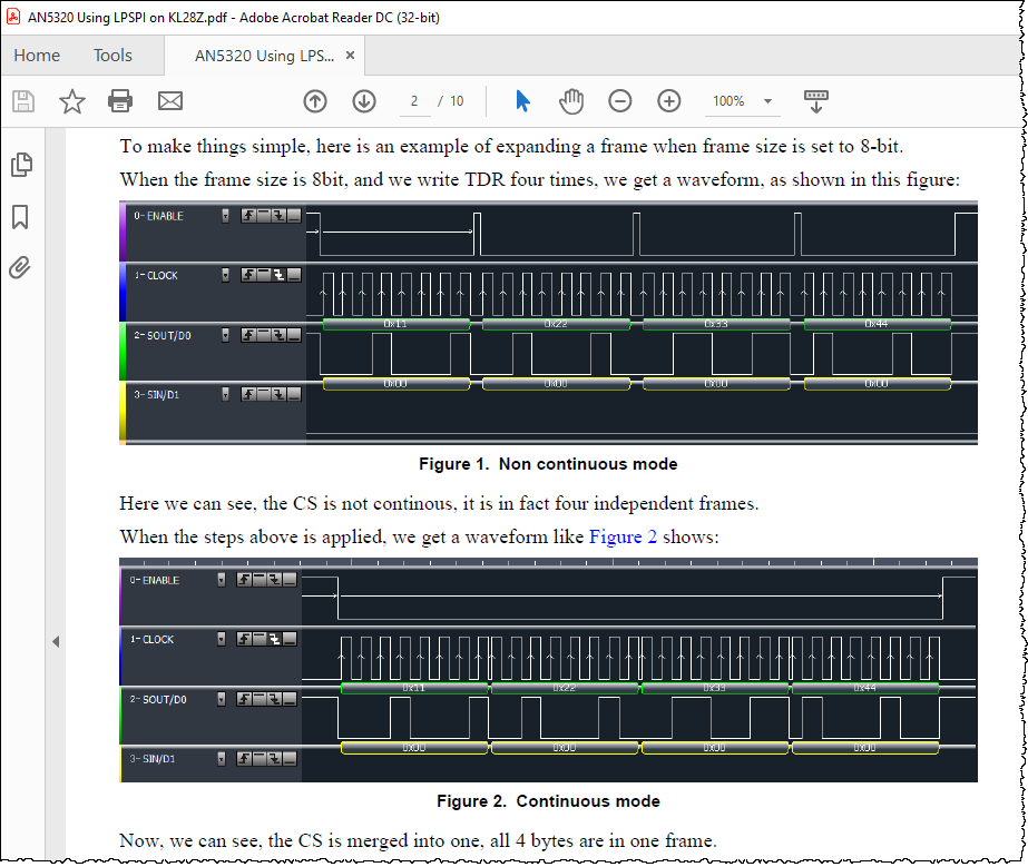

After Sending the Complete data over the SPI Only the CS Pin State need to change like below attached Format.
but in our example code if i'm sending 2 bytes of data using below code
uint8_t tx[2] = {0x25, 0x30};
LPSPI_DRV_MasterTransferBlocking(LPSPICOM1, tx, rx, 2, SPI_TIMEOUT);
The CS Pin state is changing(one time low to high) after sending every 1 byte
but i want after completion of complete data sending only the CS Pin State need to change

Robin_Shen
Did you enabled PCS continuous?

Robin_Shen
According to your previous description, you should choose Continuous mode:

Robin_Shen
Have you tried the PINS_DRV_SetMuxModeSel mentioned in my last reply?
PINS_DRV_SetMuxModeSel(PTB,5U,PORT_MUX_AS_GPIO);
OSIF_TimeDelay(500);
PINS_DRV_ClearPins(PTB,(1 << 5));
PINS_DRV_SetMuxModeSel(PTB,5U,PORT_MUX_ALT4);
35,698件の閲覧回数

Robin_Shen
Sorry. PINS_DRV_SetMuxModeSel should use PORT_Type
Please have a try:
PINS_DRV_SetMuxModeSel(PORTB,5U,PORT_MUX_AS_GPIO);
PINS_DRV_SetMuxModeSel(PORTB,5U,PORT_MUX_ALT4);
I did not debug it, so not sure whether your code works.
About the PINS_DRV_SetMuxModeSel, please check if the MUX value of PORTB_PCR[5] is change during debug.
