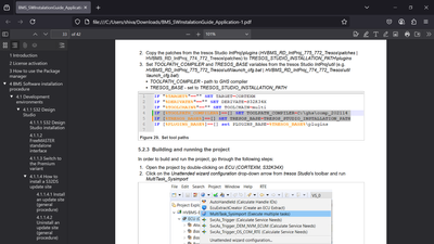

I'm trying to setup EB Tresos for HVBMS project of s32k358. In the following steps they have mentioned to add compiler path and Tresos tool path. In Compiler path it is mentioned to add GHS compiler which is commercial , can I use GNU compiler. If not how can I get GHS compiler

Refer to the release notes of the BMS version you have.
There are supported compiler listed.
This is SW32K3 BMS Application AUTOSAR 4.4_R21-11 0.8.1 D2408:
Regarding GHS compiler, please contact https://support.ghs.com/
