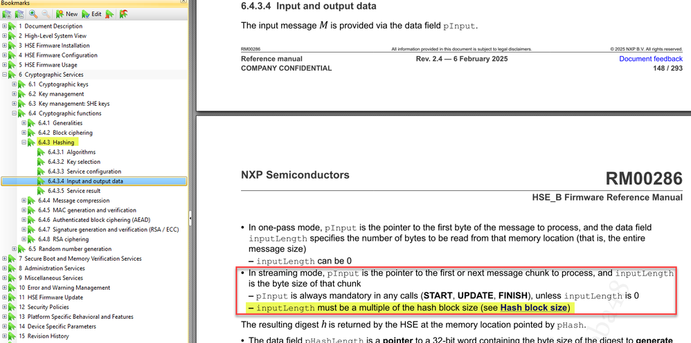

My project request to stream hash with separated location of data. for secured flashing E.g:
- 1st 4bytes are in RAM 1
- 2nd 4byte are in RAM 2
- the remaining byte (is in programming sequence so that need stream Hashing) in FLASH.
Can I use Scatter/gather input for 1st and 2nd chunks as input in START? Then the remaining bytes shall be UPDATE later?

Hi @phuong_nguyenle
Yes, it is possible to use streaming and scatter/gather input at the same time.
Attached is simple demo.
However, keep in mind that there's following limitation:
And hash block size is:
So, each stream call requires to have data aligned to n*hash_block_size.
You can have 4 bytes on one address, next 4 bytes on second address and next data on another address. This can be covered by scatter gather. But it must be n*hash_block_size in total.
Lukas
1,767 Views
lukaszadrapa
There are some troubles with the screenshot about hash block size, so I will attach it here.
