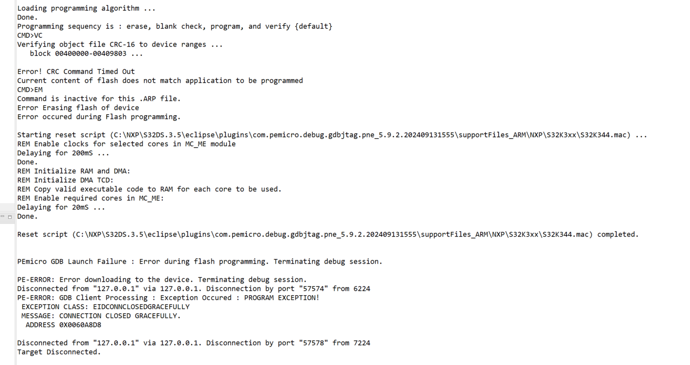

Vamsi421
Hi @VaneB ,
I am trying A/b swap ota feature in nxps32k344. In this process i am using hse feature ,i collect the .bin file of the new firmware and placed it in the memory address of 0x005000000h and run the program . After completion of my program run i reset my board but i didn't get any update firmware and i tried to flash another program my board got disconnected and provided the error logs as shared in below attachments.
