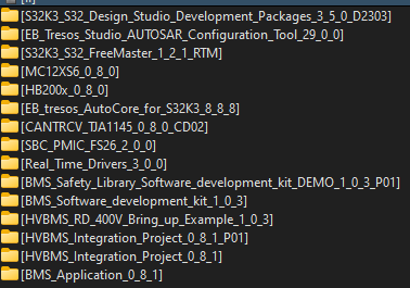

dear nxp

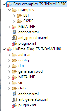

I have download sdk from below.
so, I got below.
and then,
What can I do next? Is there any documentation for this?
I tried logging into 'example' in s32ds, can I build it ? Is there any documentation for this?

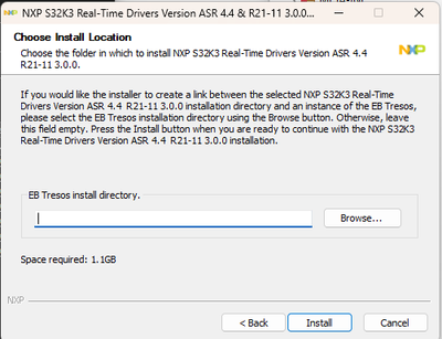

2.
What is `EB Tresos install directory` ?
Bryan

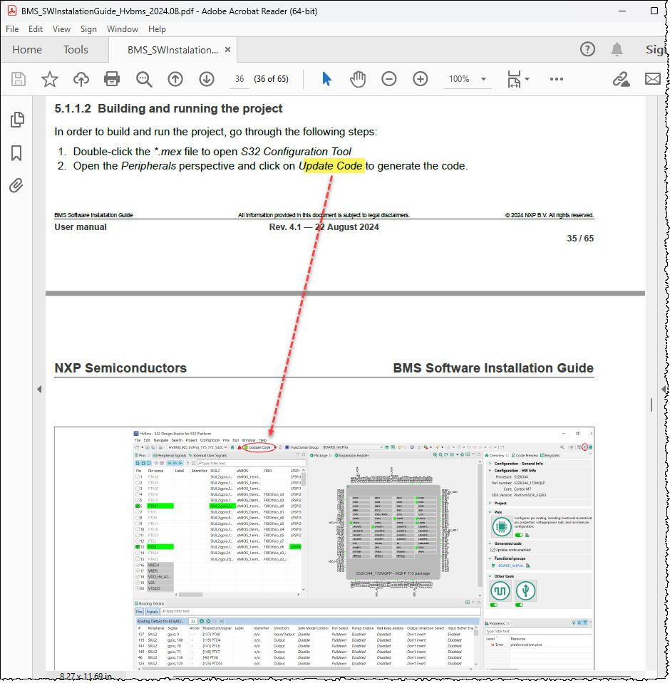

Which example did you test?
Did you click Update Code?
Open the Peripherals perspective and click on Update Code to generate the code
Open the Peripherals perspective and click on Update Code to generate the code.jpgOpen the Peripherals perspective and click on Update Code to generate the code.jpg

I have found  `OsIf_Cfg.h` file on `c:\NXP\S32DS.3.5\eclipse\mcu_data\components\PlatformSDK_S32K3\Base\`
but, I have meet below compilation error as below.
Invoking: Standard S32DS C Compiler
arm-none-eabi-gcc "@Project_Settings/Startup_Code/exceptions.args" -MMD -MP -MF"Project_Settings/Startup_Code/system.d" -MT"Project_Settings/Startup_Code/system.o" -o "Project_Settings/Startup_Code/system.o" "../Project_Settings/Startup_Code/system.c"
../src/main.c:26:10: fatal error: CDD_Bms_SpiIf.h: No such file or directory
26 | #include "CDD_Bms_SpiIf.h"
compilation terminated.
In file included from C:/NXP/S32DS.3.5/S32DS/software/PlatformSDK_S32K3/RTD/BaseNXP_TS_T40D34M30I0R0/include/Mcal.h:65,
from ../Project_Settings/Startup_Code/exceptions.c:41:
C:/NXP/S32DS.3.5/S32DS/software/PlatformSDK_S32K3/RTD/BaseNXP_TS_T40D34M30I0R0/include/OsIf_Internal.h:45:10: fatal error: OsIf_Cfg.h: No such file or directory
45 | #include "OsIf_Cfg.h"
make: *** [src/subdir.mk:20: src/main.o] Error 1
make: *** Waiting for unfinished jobs....
make: *** [Project_Settings/Startup_Code/subdir.mk:42: Project_Settings/Startup_Code/exceptions.o] Error 1
from ../Project_Settings/Startup_Code/system.c:47:
make: *** [Project_Settings/Startup_Code/subdir.mk:42: Project_Settings/Startup_Code/system.o] Error 1
"make -j12 all" terminated with exit code 2. Build might be incomplete.
13:50:58 Build Failed. 7 errors, 0 warnings. (took 360ms)

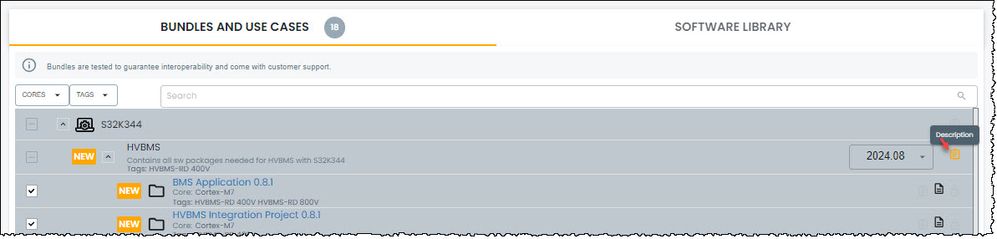

Hi Bryan,
Please click on the upper right corner to download BMS_SWInstalationGuide_Hvbms_2024.08.pdf.
Then refer to the section ‘4 BMS Software installation procedure’.
Why you did not download S32DS Design Studio 3.5 and S32DS Design Studio 3.5.3? Did you already install those two software?

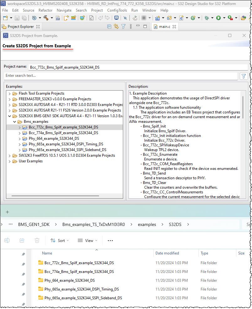

If you want to test Bms_examples in S32DS, please click File->New->S32DS Project from Example
Create S32DS Project from Example Bms_examples.jpgCreate S32DS Project from Example Bms_examples.jpg
2. What is `EB Tresos install directory` ?
Please refer to How do I link EB Tresos to the S32K3 RTD Drivers
You are installing S32K3 RTD 3.0.0 used by EBTresos, so it is recommended to enter the path after installing EB_Tresos_Studio_AUTOSAR_Configuration_Tool_29_0_0. For example, C:\EB\tresos_29

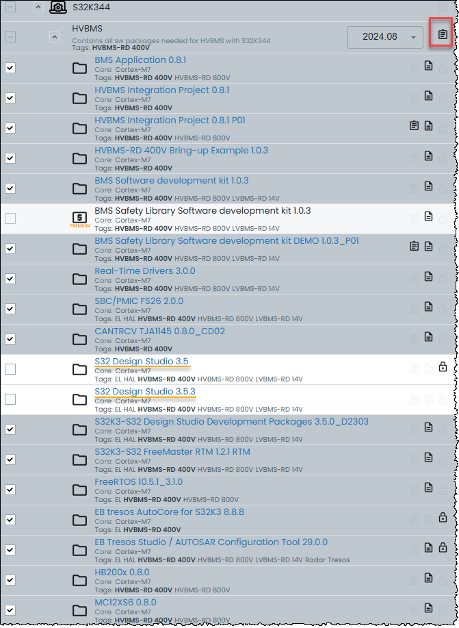

Robin_Shen
HVBMS DESCRIPTION download BMS_SWInstalationGuide_Hvbms_2024.08 or 10.jpgHVBMS DESCRIPTION download BMS_SWInstalationGuide_Hvbms_2024.08 or 10.jpg
