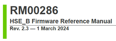

Dear NXP team,
Currently, We are referring to HSE_DEMOAPP_S32K396_0_2_50_0 to see how to update new HSE firmware (AB SWAP to AB SWAP FW update).
The first step is that programs IVT and Encrypted HSE F/w V2 Image in Active Partition as below picture (mentioned in HSE_DEMOAPP_S32K396_0_2_50_0_ReadMe.pdf).
Due to the memory limit, Is that possible to store Encrypted HSE F/w V2 Image in RAM for updating?
Hai Nguyen Hoang.

Hello ,
u are updating FULL MEMORY TO AB_SWAP ??  Which manual u are referring  please do share it .
3,320件の閲覧回数
HaiHoangSoftware
We are planning to upgrade HSE Firmware from AB_SWAP to AB_SWAP.
Here is the document, but I can not share it due to security reason. Please contact NXP support to get it.
