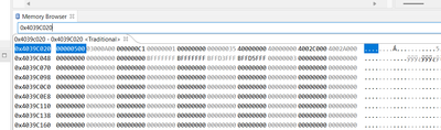

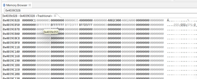

Hi @Sanjana_k
All the changes and steps required to complete the HSE firmware installation using the S32K344_HSE_FW_INSTALL application are documented in the Readme.md file located at:
C:\NXP\S32K3_HSE_DemoExamples_1_0_0\S32K3_HSE_DemoExamples\Device_Configuration\S32K344_HSE_FW_INSTALL\Readme.md
Additionally, could you please provide an image showing the contents at addresses 0x4039C020 and 0x4039C028?

Hi @Sanjana_k
Based on the value at HSE_CONFIG_GPR3 (0x4039C028), HSE is already installed on the device. The project you are flashing is intended for installing the firmware, so there is no need to flash it again.
My recommendation is to update the SBAF version to the one compatible with your current firmware version. This compatibility was discussed in the thread S32K344 Chip SBAF Version and HSE FW Version Compatibility Issues.
