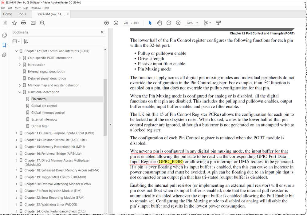

Robin_Shen
Hi abhinandan,
Although the description of PINS_DRV_ReadPins shows: This function returns the current input values from a port. Only pins configured as input will have meaningful values.
But I think you can still read the pin state via the GPIO port data input register (GPIO_PDIR).
pin state to be read via the corresponding GPIO Port Data.pngpin state to be read via the corresponding GPIO Port Data.png
Robin

Robin_Shen
How about direct read the value of GPIO_PDIR?
When pin is configured as input with internal pull down enabled, then test PINS_DRV_ReadPins.
When pin is configured as output and output high or low, then test PINS_DRV_ReadPins.
