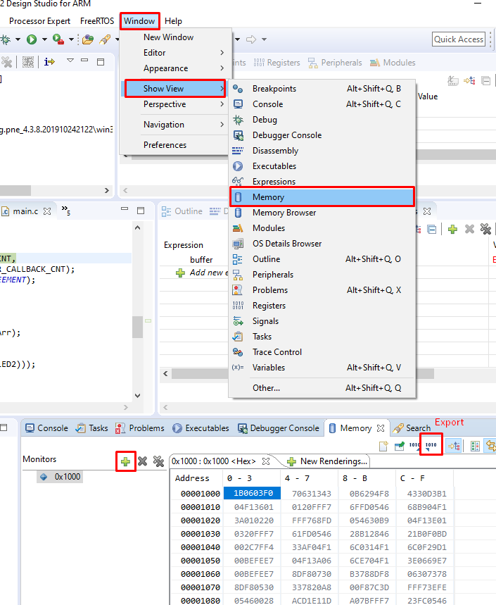

I am working on software update utility on S32K148 chip. To know whether the SW was flashed correctly or not, a dump of entire 2 MB of codeflash will be helpful.
Can you please help in knowing if there is any such utility in S32K design studio for the same?

Memory dump can be performed in the S32 Design Studio in the Memory view. Also, you can export memory into the file by export button see image below:
